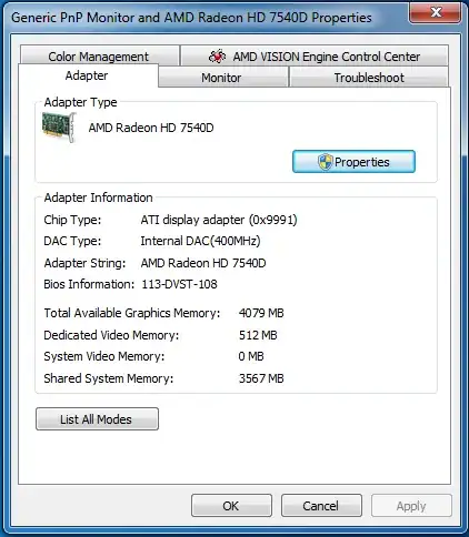

Display adapter method To view your computer's maximum graphics memory:
  1. Right-click the desktop.
  2. Select the option for Screen Resolution.
  3. Open the link for Advanced Settings.
  4. The total available graphics memory is listed under Adapter Information in the Adapter tab.
enter image description here Figure 1: Graphics Memory View from Adapter Tab in the Adapter tab.
"Dedicated Video Memory" is what is set in your system settings in setup before your system boots
"Shared System Memory is additional RAM that can be allocated dynamically at the will of the OS
"Total Available Graphics Memory" is the total of the two mentioned abov added together
"System Video Memory" May be '0' but would show vedio memory that is 'Dedicated' on a gpu card.
