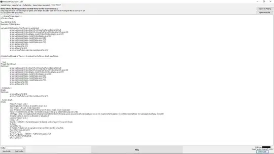

Error 2 (Minecraft):
After pressing "Play" on the launcher (set to any version) the launcher closes for a couple of seconds, then opens again with an error:
Minecraft Error The main part of the above image that I saw is:
OpenGL: ~~ERROR~~ RuntimeException: No OpenGL context found in the current thread.
