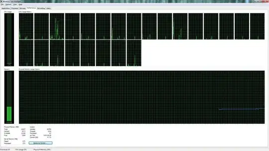

My computer is running very slow, so I opened up the task manager expecting to see excessive cpu or memory usage. Nothing. So I closed all applications other than task manager. Still slow. Then I opened up the resource monitor, and found the cpu being used almost to the max! What could cause such a discrepancy? Another words, why does taskmgr show barely any cpu usage, while the resource monitor shows that the cpu is overloaded?
EDIT: Others have pointed out that I incorrectly identified the blue line in the resource monitor as cpu usage. Thank you for that, but I still don't know what to do about my slow computer.
Task Manager
Resource Monitor

    Where did you see overloaded CPU on resource monitor screenshot? – user364455 Oct 11 '16 at 21:39
  • Look at the blue line in the top graph: CPU_Total. Plus, the computer is unbearably slow. I have like 12 cores, 24 logical processors, 16 GB RAM, and it takes me 10 seconds to click on something in windows explorer. Doesn't make sense. This is the only trace of bottleneck I've found. As you can see, task manager was useless. – user3685285 Oct 11 '16 at 21:42
    The blue line = % of max. processor frequency, not CPU usage (that's the green). See the link for more info. – Ƭᴇcʜιᴇ007 Oct 11 '16 at 21:46
    This could be a simple case of performance being limited due to a balanced power setting. Try going to Control Panel, Power Options, and make sure the "High Performance" powerplan is selected. If this is the case, the improvement should be immediately. – LPChip Oct 11 '16 at 21:51
  • what is slow in detail? – magicandre1981 Oct 12 '16 at 07:24
  • The mouse is not slow. But when I mouse over the start button for instance, it takes a good 5 - 10 seconds to acknowledge that it has been moused over and light up. This goes for anything in the start menu. It takes even longer when I click to change to a different window. That can take 10 - 30 seconds. And doing anything in the window? Forget about it. This is consistent behavior, and only happens after not shutting the computer down for a few days, so something is definitely building up over time in the background. – user3685285 Oct 12 '16 at 13:02
  • What about memory utilization and I/O load? – Seth Oct 12 '16 at 13:07
  • I agree with @Seth, I once had a laptop that had good specs but the hard drive was unbearably slow, causing everything else to slow down with it. – Cas Oct 12 '16 at 13:26
  • But as you can see from the pictures, I was barely using any memory, and had closed everything except for task manager and resource monitor. The issue is that it was enough for the OS to slow down. That is what is concerning me. – user3685285 Oct 12 '16 at 14:30
  • capture a xperf trace of the slowness and share it: http://pastebin.com/JLz6FW18 – magicandre1981 Oct 13 '16 at 07:11
  • have you captured the trace? Otherwise I can't help you – magicandre1981 Oct 15 '16 at 08:04
