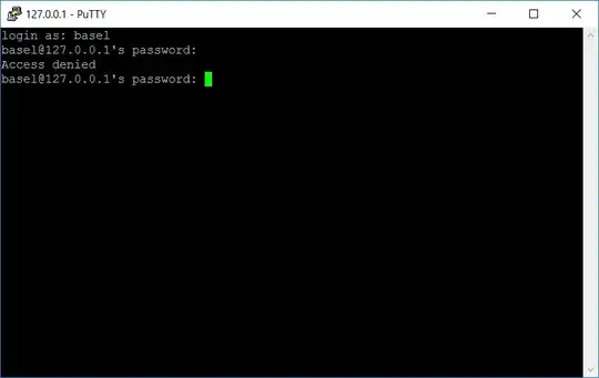

I followed the instructions in this answer:
How can I SSH into “Bash on Ubuntu on Windows 10”?
I'm attempting to SSH from PuTTY in Windows on the same machine. Using Port 22, which matches my config file. Tried both 127.0.0.1 and 127.0.1.1. However, I'm still getting "access denied":
Ultimately I'm hoping to set up a Visual Studio remote build, but I've been thus far unable to get in remotely at all. What next steps should I take?

  • An "Access Denied" means you are providing the incorrect password to the account base1 – Ramhound Sep 12 '16 at 14:26
    I'm definitely not providing the incorrect password. I've changed it and retried a few times just to make sure. – Basel Alghanem Sep 12 '16 at 14:32
    I absolutely did try looking around, for a couple hours this morning. Unfortunately I'm generally unknowledgeable in this area. I tried commenting out the line as suggested in an answer, and that didn't help. Do you think trying key-based auth might work? – Basel Alghanem Sep 12 '16 at 15:09
  • Update: When I ssh into 127.0.0.1 or 127.0.1.1, I am able to log into Windows using my Windows credentials. I'm thinking maybe I need to use a different port because 22 is being used by Windows? – Basel Alghanem Sep 12 '16 at 16:27
  • If you used key-based authentication, and it works, then its an authentication problem. If you change the port, and it works, then you still have authentication problem – Ramhound Sep 12 '16 at 16:36
    Switched to port 2200 (line 5 in sshd_config) and was able to successfully log into WSL. I guess Windows was using port 22 so Linux couldn't? Additionally, sshd showed up in Process Hacker as listening to port 2200, where it didn't show up at all before. Do I submit this as an answer to my question? – Basel Alghanem Sep 12 '16 at 16:40

52
Change the 22 port to a other one,such as 2222,in the file /etc/ssh/sshd_config,then restart the ssh service by the commond sudo service ssh --full-restart,you will successfully login.But I don't know the reason.
I also try use it as a remote gdb server for visual studio by VisualGDB,it not works well. VisualGDB will support it in the next version as the offical website shows.The link is https://sysprogs.com/w/forums/topic/visualgdb-with-windows-10-anniversary-update-linux-support/#post-9274

    This is because Windows might run SSH Server Broker on port 22. Unless you know for sure that you need it, it can be safely disabled. It is used for some procedures during development. – ᄂ ᄀ Mar 06 '17 at 20:44

Port 22 does not work because Windows comes with a built in SSH server.
Windows 10 comes with an SSH server, and it will either need to be disabled or the port that will be used for SSH on WSL will need to be changed. I chose to do the latter and use port 2200 for WSL SSH.

Contrary to the accepted and other answers here. The port does not have to be changed. I was able to successfully connect on port 22 to my OpenSSH server runnin inside Ubuntu 18.04 WSL on port 22. It seems that in addition to the user explicitly running the Windows OpenSSH server explcitly, Windows can also run the OpenSSH server in the background without the user explicitly enabling it, this happens when you enable "Developer Mode" in the new settings.
If you are trying to login to your WSL OpenSSH server, but you are ending up at a batch/cmd prompt in your Windows home folder, then Windows is running an OpenSSH server on port 22 in the background and is not letting WSL use it for outbound traffic.
If you want to connect on port 22 to your OpenSSH sever in WSL then try the following steps:
  1. Start not logged into SSH.
  2. If you don't have one already, open Windows Firewall, select Add Rule and configure it to allow incoming traffic on port 22.
  3. Open the new Windows 10 "Settings" app, navigate to "Updates & Security" and to the section "For developers"
  4. Turn off the option for "Device Discovery -- Make your device visible to USB connections and your local network."
After doing this, I was able to connect to the openssh-server inside of my WSL instance on port 22.
