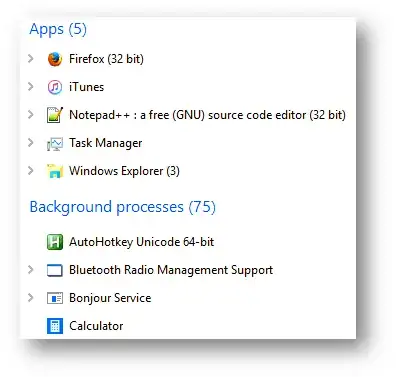

With Windows 10 I have noticed that it only works intermittently. The first time I launch it following a reboot, everything works as normal. However, sometimes when closing the Calculator app, it saves it in the Background Processes, rather than truly exiting out.
When I activate the script, the IfWinExist will find it as running and (apparently) activates it but with no visible effect since it's a background process. If I open Task Manager and kill the process, normal function returns (for a while).
Is there any way to either prevent Windows from leaving the Calculator as a Background Process, or to make AutoHotKey distinguish between Apps and Background Processes?

    That other question was helpful but ultimately not effective, since Calculator is not included in the Background Apps options and they had no other suggestions besides "use a different program". – techturtle Aug 24 '16 at 19:01
  • My other idea is use autohotkey in someway. When the calculator is open, it moves up to the apps portion in task manager yes? Maybe you can modify your script to first kill the calculator background process and then reopen it. Not sure if it's possible to differentiate between a background process and an active application in autohotkey though. – Tim G. Aug 24 '16 at 19:09
  • Also, my calculator is included in the background apps section. I can toggle it on and off. – Tim G. Aug 24 '16 at 19:48
    This background process stuff is all messed up. On my main desktop at home it is almost always in the background. On my laptop it is rarely in the background but that one has it is the "background apps" section while none of my other PCs have it. I thought maybe it was the Win10 Anniversary Update, because the laptop has it but the desktop doesn't, but I just upped the desktop and it didn't get it. – techturtle Aug 25 '16 at 12:33
  • As far as using AHK to check if the background process was running, that is one of the options I was hoping someone could tell me here. I have been unable to find a way to distinguish between background or not. I could probably just kill any calculator windows it finds and then open a new one, but I'd prefer not to do that because #1 if I'm using the calculator a lot I may want the value to be retained, and #2 killing it may just shove it in the background which would ultimately not solve the problem. – techturtle Aug 25 '16 at 12:39
    A couple of Windows Updates later and the calculator option appeared in Background Apps on both my computers. Unfortunately, the process is still appearing in the Background Processes section of Task Manager despite this setting, so it appears that finding a way to distinguish active vs background processes will be the only way to fix this. I've still had no luck on those grounds yet... – techturtle Aug 30 '16 at 11:48
