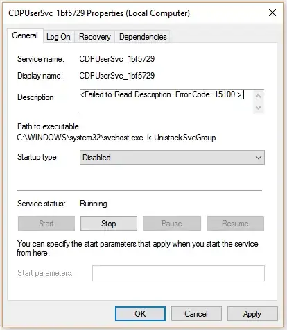

In my machine there's a service called CDPUserSvc_1bf5729. The description says
Failed to Read Description. Error Code: 15100
The path to the executable is C:\WINDOWS\system32\svchost.exe -k UnistackSvcGroup, and the startup type is Automatic. If I attempt to set the startup type to Disabled, I got an error message saying "The parameter is incorrect".
What is this service?

    The name ending in a hash is because it is running for a specific user. Windows supports multiple user accounts simultaneously logged in at the same time and this service runs with the relevant user’s account to limit the damage to the system or other users if the service is compromised. Anyway, to be registered as a service, it probably needs a unique name, so to avoid having a name that conflicts with another user account’s service, the hash is appended. – binki Jun 18 '22 at 16:02

It's part of Connected Devices Platform Service.
CDP Service itself says: This service is used for Connected Devices and Universal Glass scenarios.

If you want to disable the service, you can do so by modifying both the registry keys with the name:
HKEY_LOCAL_MACHINE\SYSTEM\CurrentControlSet\Services\CDPUserSvc
In both keys, modify the value Start from 2 to 4 and restart.

The reason it fails to read the description is actually because the service doesn't have a describer assigned to it. The services' description tag is empty so it's basically trying to read a description that is not there.
It should not effect it's ability to run and perform. Descriptions are for user's eyes only and have nothing to do with the actual functionality of the system.
It cannot be disabled because the service is a critical kernel-level service, just like how the RPC service is. Disabling it will cause core components to fail. It's also required for the settings app to function and any windows store apps that use wireless adapters (Bluetooth, NFC, etc) will fail to run. The service is deliberately locked by the Windows team to keep people from disabling the service and BSOD their PCs (I was able to remove most of the security around this service to disable it on a test machine. Each time it will blue screen when disabled).
