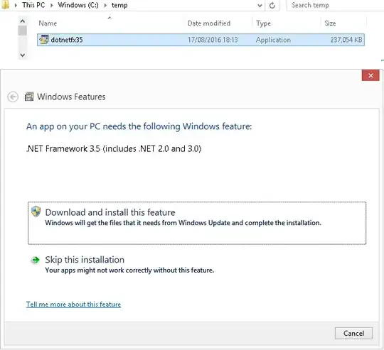

I am running the .NET 3.5 offline installer on windows 8.1 from Microsoft .NET Framework 3.5 Service pack 1 (Full Package) . Though, when I run this exe, it still prompts me to install from windows update. The same thing happens with the pre-service pack installer.
Even if I am connected to the internet, the download never completes and freezes on 'Downloading required files'
Does anyone have any insight to what could be wrong?
dotnetinstall
Edit: Daniel B brought to my attention that this package is not supported for windows 8.1. I will be taking the route of installing via the windows 8.1 ISO.

    This installer is not applicable to anything starting from Windows 7, which included .NET 3.5 as a base component. It’s for Windows Server 2003, Windows Server 2008, Windows Vista and Windows XP. Starting from Windows 8, the .NET 3.5 component is not installed by default (.NET 4.x is instead). – Daniel B Aug 17 '16 at 18:27
  • Thanks Daniel. I updated my post. I think I will be forced along the ISO route. – mt025 Aug 17 '16 at 18:38
