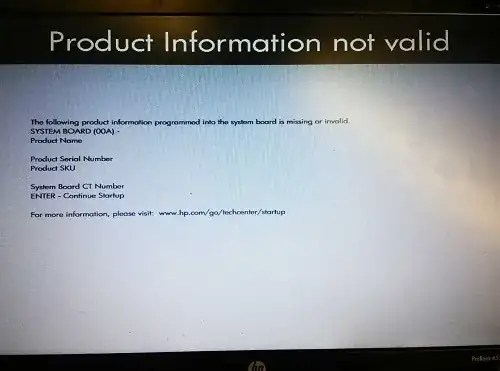

4-2- SUCCEED, if you see the BIOS reset screen that lets you in, you succeed.
You are FREE now, but you may lose product serial numbers in BIOS too. ( Doesn’t important to me due to they are printed on mainboard labels. You will lose them if you buy a new chip & solder it too! THIS MEANS YOU HAVE NO OTHER OPTION! :)
