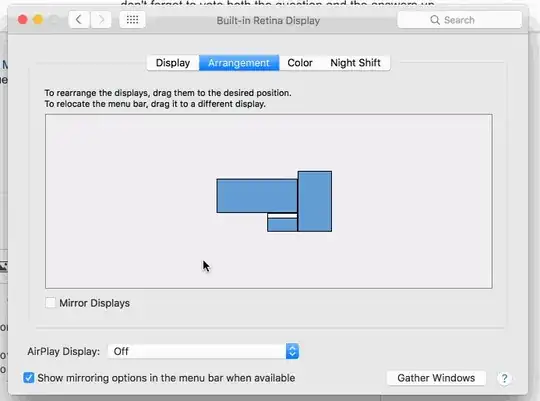

Yes! I have 4 external monitors and this drove me nuts until I figured it out. Play around with moving the "top" bar between screens in the Arrangement window. Assign it to different screens and you will notice it will solve your issue once you find the "right" screen. I can't remember why that worked, but it did.
How to move the top bar between Mac windows
Alternatively, you can also drag one of the Mac windows around and then let it drop back into place.
How to shortly move the Mac windows arrangement

    Screenshots here: https://apple.stackexchange.com/a/296905/206646 – ognockocaten Aug 30 '17 at 19:24
