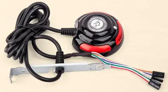

If your motherboard has a pair of RESET pins (look for "front panel connector", "system panel header" or the like in your motherboard's user manual to learn which pins you need), you can use an external button like the following one (image source):
example external button
Just look for "external power button for PC" on the Internet. These most often come with a reset button and power&HDD LEDs to complete your "virtual front panel".
