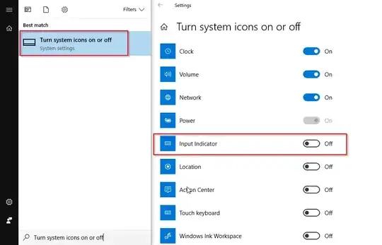

Search for
Turn system icons on or off
It should come right up.

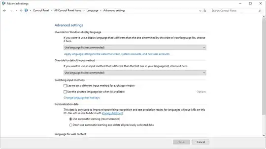

Control panel location: Control Panel\Clock, Language and Region\Language\Advanced settings > Options > Hidden [Check]
Update: If the above does not work - Try the path Control Panel\All Control Panel Items\Language and advanced options will be on the left.

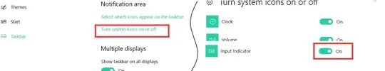

There seems to be 2 type of LANGUAGE icons in windows 10 at least, one is the one we were used to in Windows 7, and you could hide it right clicking it and changing the checkboxes.
In Windows 10 (I have Microsoft Windows v10.0.15063.502), this one
New W10 Icon
is hidden by entering Taskbar Settings, then under Notification Area select "Turn system icons on or off" , then switch "Input Indicator" off:
w10SysIcon.

This appears to be a bug in the latest version of Windows 10. To hide the language bar, you have to turn it ON, then go to Options and Hide it:
Control Panel || Clock, Language, and Region || Language || Advanced settings
(If you have the full Control Panel showing, click on Language || Advanced Settings)
Check "Use the language bar when available". Click Options. Select "Hidden".
This is counter-intuitive, I know, because if you UNCHECK "use the language bar when available", that makes it show on the task bar. That's why I think this is a bug.
