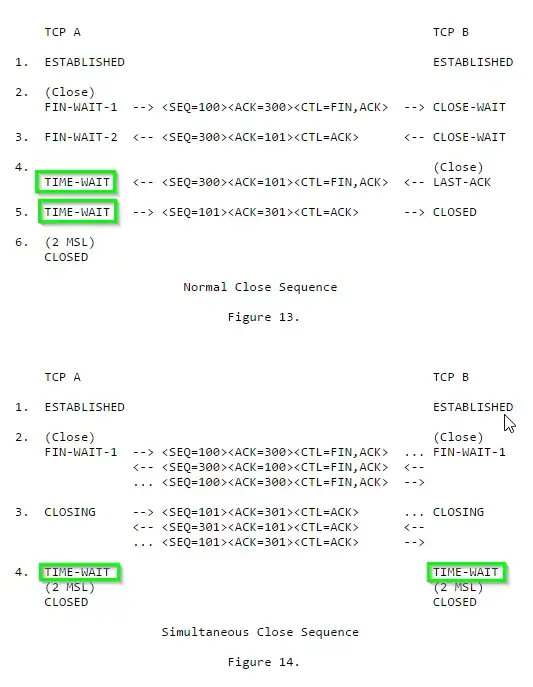

TIME-WAIT
(either server or client) represents waiting for enough time to pass to be sure the remote TCP received the acknowledgment of its connection termination request. [According to RFC 793 a connection can stay in TIME-WAIT for a maximum of four minutes known as two MSL (maximum segment lifetime).]

rfc793: image source
enter image description here image source
