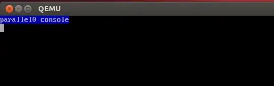

I'm running QEMU on Linux without GUI.
After running starting my custom kernel with QEMU, I can't kill and return to host by pressing Ctrl+C.
Is there any way to get back to host OS?
