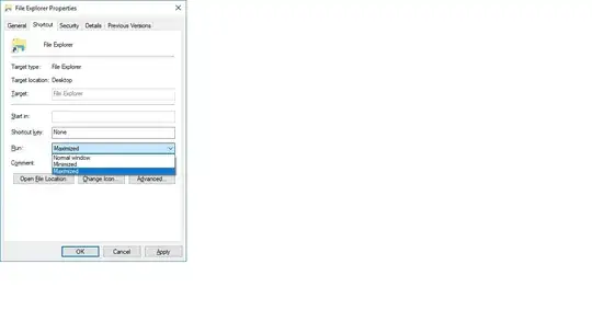

What I did was
  1. hold down the Left shift key, right-click on the File Explorer Icon, and select Properties. Image for step 1
  2. Select the Shortcut Tab at the top
  3. Change the contents of the Run drop-down from "Normal Window" to "Maximized" Image for step 3
This worked for me, I hope it helps others
olddad
    Does this really remove the "Working on it..." message? This only tells explorer to open in a maximized window, doesn't it? – Vylix Jul 01 '17 at 12:41
