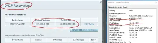

Reserve the LAN address for my mac to 10.0.0.11. So you did something like this:

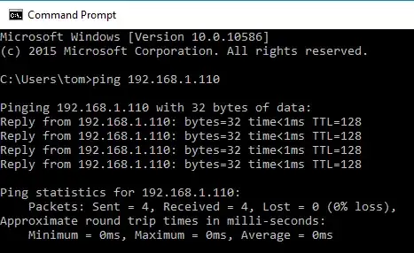

It is not really relevant to your issue though. Anyway, you can certainly ping this address from your PC:
(I actually wonder if an OS would even route it to your router when it can easily recognize this is its own address)

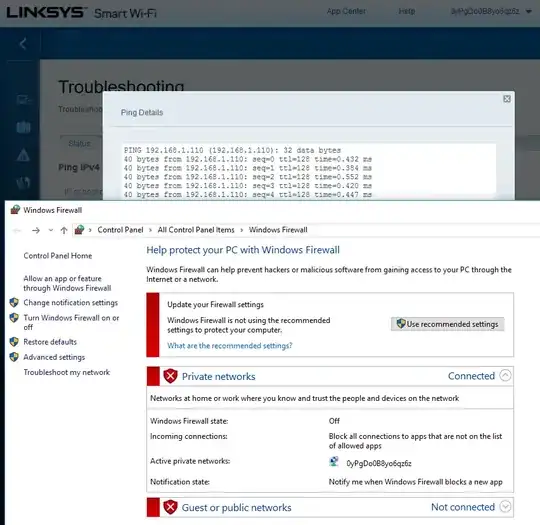

However, with your Windows Firewall on, you won't be able to ping from your router to your PC:
Once your have configured it properly, or have it disabled (for testing), it will ping fine:
