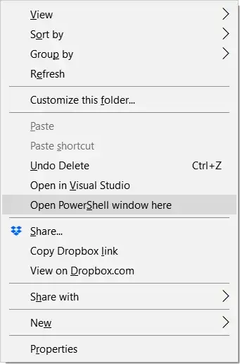

Alternatively,
  1. Hold down Shift while right-clicking in your desired Windows directory
  2. Select "Open PowerShell window here"
PowerShell Context Menu
  1. Once you're in PowerShell, type bash
You'll be able to use any Bash commands directly to operate on the files and folders in that Windows directory. By using this method, you don't have to manually cd into your directories especially when you've a deep-rooted directory to access.
Update as of Windows 10 1809:
Above still works, but there's an easier method now.
  2. Select "Open Linux shell here"
Keith OYS
  • 491
    In my right-clicked context menu, I don't see the item for Open PowerShell window here – Yu Shen Apr 24 '18 at 01:47
    yep, same here..... – Yaroslav Dukal May 13 '18 at 03:33
  • @YuShen Do ensure that you've the latest Windows 10 update installed. For instance, the current version is 1803 and it has the option. I realize some machines which weren't updated still has CMD as their default and hence does not have this option in the context menu. – Keith OYS May 27 '18 at 12:55
  • It doesn't work, the bash commands opens in default ubuntu user directory, not curret windows directory – mxdsp Oct 22 '18 at 16:44
  • @mxdsp What were your steps and your Windows version? Please detail it out for me so I could help you further. If you did it correctly, it would bring you into your current windows directory. Ain't wise downvoting just because it doesn't work for you. – Keith OYS Oct 23 '18 at 17:21
  • You can change the default from CMD to Powershell and back again by following these steps. Start > Settings > Personalization > Taskbar > Replace Command Prompt with Windows PowerShell in the menu when I right-click the start button or press Windows key+X – Nathaniel Sep 13 '19 at 03:40
  • The updated answer for Windows 10 >=1809 is exactly what I was looking for. Note to others that you must right-click on the folder you're wanting to "cd" to in Ubuntu - you can't navigate inside that folder and right click in the file pane or right click in the address bar. – Luke Aug 29 '20 at 12:15
  • It worked, it's much more easy to use Linux Bash with Powershell. Thanks ! – Enrique Benitez Mar 02 '21 at 15:19
