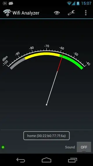

If you have a Android smartphone or tablet, you can use the WiFi Analyzer app. It has a screen dedicated to detecting proximity of access points:
Screenshot of "Wifi Analyzer"
Walk around the house and see where the signal is the strongest.

    I have actually used this app for playing a variant of the "hiding" game with the kids. One hides a spare router somewhere in the house, and the other ones try to find it. The gauge is actually quite helpful and this app can be configured to scan once a second. We had some fun with it. – Marcel Apr 11 '16 at 07:22
    I love this app, it's one of the first I installed when I switched to Android and it gets used at least every couple weeks... and it works great for this situation too – Taegost Apr 11 '16 at 17:09

  • @gronosta, How does this app work? – Pacerier Mar 11 '18 at 13:04
  • @Pacerier It shows a list of Wi-Fi networks in range and lets you select yours, then shows the strength of signal as you walk around the building. It also plays sounds so that you don't have to look at the screen all the time. – gronostaj Mar 11 '18 at 16:54

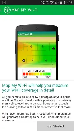

ekahau Heat Mapper
It can make a map for you, that should give you a better idea of which corners to be concentrating your search in. It's for Windows, How-To Geek has a little guide about it. They say it's "essentially the free version of the multi-thousand-dollar Ekahau SiteSurvey."
The best part: It may find the router for you.
once we finished walking the entire map, HeatMapper pinpointed the location of the two access points within our office with uncanny precision. Look at the red arrows on the map below:
