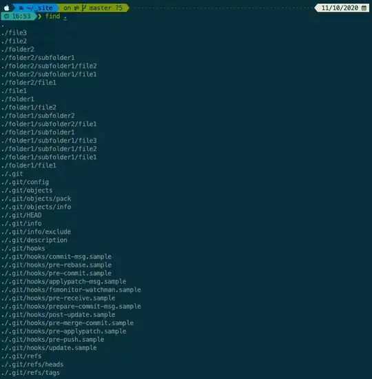

So first, what I did was to write a find . command and see what I'm getting:

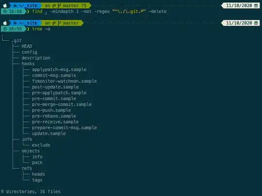

Then I wrote find . -mindepth 1 -not -regex "^\./\.git.*" to exclude the .git folder and all its contents:
Now that I'm happy with the results, all I had to do is to pass the -delete flag to my find command, resulting in find . -mindepth 1 -not -regex "^\./\.git.*" -delete:
