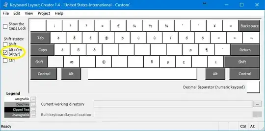

This may not exactly be what you're looking to accomplish but I believe the US - International keyboard layout already has the Swedish characters that you need. They're made available through AltGr (i.e. the right Alt key or Ctrl+Alt) shortcuts.
Glyph               Shortcut               Shortcut (No AltGr)
å                   Right Alt+w          Ctrl+Alt+w
ä                   Right Alt+q          Ctrl+Alt+q
ö                   Right Alt+p          Ctrl+Alt+p
Å                   Right Alt+Shift+W   Ctrl+Alt+Shift+W
Ä                   Right Alt+Shift+Q   Ctrl+Alt+Shift+Q
Ö                   Right Alt+Shift+P   Ctrl+Alt+Shift+P
Some Ctrl+Alt shortcuts may trigger other action on certain programs.
For instance Ctrl+Alt+p would open the Print dialog in Notepad.
You can check what characters are available to you using Microsoft Keyboard Layout Creator by loading your existing keyboard profile through File → Load Existing Keyboard... and checking the Alt+Ctrl (AltGr) shift state.
Keyboard Layout Creator 1.4 - AltGr shortcuts
