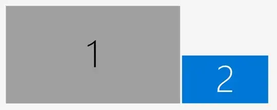

Another problem is the virtual wall between the screens I can't move the cursor from the upper half of the 4K screen to the Full HD screen:
Windows creen settings
How is it possible to virtually stretch the cursor transition area of the Full HD screen to the one of the 4K monitor?

Found this solution, which should at least fix the virtual wall problem, on a different thread, originally from Steve:
Perhaps LittleBigMouse could help you out? It's an alpha application, but it seems to be focusing on the issue you're having.
Github: https://github.com/mgth/LittleBigMouse
Download (Releases): https://github.com/mgth/LittleBigMouse/releases
I have been using it myself with a 4K UHD monitor and a 1080p Full HD monitor and this does exactly what you want.
As for the cursor speed, this can be solved by changing the scaling of the screen within Windows. For example set your 4K display to 200% and your 1080p screen to 100%. Then the cursor size and speed should be the same on both screens.

Thats a dpi issue, not related to windows, see, a 4k moniter has more pixels while a full HD one has less pixels, you either have to get a 'on-the-go dpi adjustable' mouse like a razer perhaps, or use the windows inbuilt mouse speed option in main.cpl (tho it will increase the mouse speed on the full HD screen also), and alternatiely the best sollution, a program that sets 'custom desities' on two different screens. As for the Virtual wall, changing your display size of the FHD display to 200% should work, the bigger mouse pointer would also be solved by this i suppose, I cant tell if the mouse pointer will be solved or not because i use 2 x 1080p displays for gaming.
