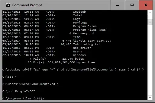

Solution 5: Doskey
Not sure if you've been around since the dos days.. However, it's possible to overwrite command behavior using doskey macros. It's quite fun actually and doesnt require you to install any 3rd party software.
Here's a good example:
doskey cd=if "$1" equ "~" ( cd /d %userprofile%\Documents ) ELSE ( cd $* )
And a winning screenshot to go with it.
    You probably want to add a /d to the cd %userprofile%\Documents so it works even when on other drives. – Ben N Mar 04 '16 at 17:30
  • There is another problems with this solution: cd "WebCam Media" returns Media" ) was unexpected at this time.. – DavidPostill Mar 04 '16 at 18:39
  • The command is called doskey.This shows Windows still uses the DOS command prompt – Suici Doga Mar 05 '16 at 03:04
    @SuiciDoga Sorry, that's not correct. The command prompt just has a lot of compatibility features to make old batch files still run. cmd.exe is very much a Windows program, and is even 64-bit on 64-bit systems. – Ben N Mar 05 '16 at 21:54
  • Note even though folder completion doesn't work with it due to double quotes. It will work with wildcards without double quotes. Also thanks @BenN – NotAdmin Dave Mar 06 '16 at 02:32
