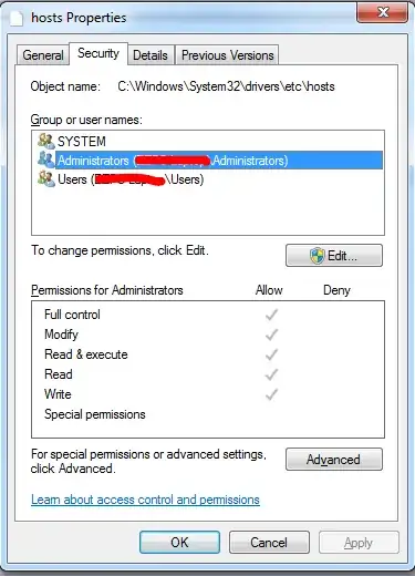

After this, if it is strictly a permission issue; it could be that the malware changed the file permissions.
Simply right click on the file and go to Properties. Go to the Security Tab and add check what is set to denied, and uncheck them as well as making sure that you have full permissions.
The defaults for the hosts file should look like this:

If it is not a permission issue, and/or if you are still having trouble after this, download Microsoft / Sysinternals Process Explorer, go to search/find and type hosts. It should be able to tell you which process is locking the file. This may be something innocent such as AV or similar, or it could be more malicious and be a result of malware still being present.
