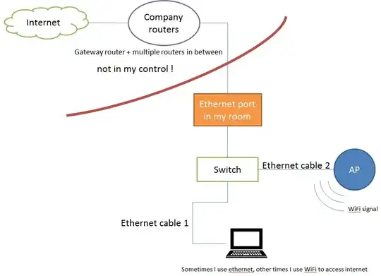

Here below are two images, one showing the network config and other one showing the topology of my laptop
image 1 - network setting of VM
image 2 - noob topology design of network

Although it's worth to mention that the VM is in a different subnet. Is that the expected behavior of "bridged adapter" ?
I suspect that the problem doesn't lie at the VM but at how the network is set up ? I do have networking knowledge, but only basic. And since i don't understand how the virtual adapter works, i don't see directly a clue where the problem is.
Or is the problem at Windows 10 itself ?
Maybe someone can point me to the problem and provide a solution ? That would be appreciated.

  • The lack of communication between host and guest is surely due to their lying in disjoint subnets. You should post the output of ip route show on the Ubuntu guest. Also: 1. Does your network use a MAC filter? 2. Does it use VLANs? Do you have a guest network? – MariusMatutiae Mar 02 '16 at 15:22
  • Also, perform this experiment: sudo service network-manager stop; sudo ip link set dev eth0 down; sudo ip addr flush dev eth0; sudo ip link set dev eth0 up; sudo ip addr add 192.168.1.217/24 dev eth0 ; ping -c1 192.168.1.42. Do you get a reply? Please make sure that the host is connected via ethernet, and that, under Network, you have chosen: Name: eth0 (or ethernet, or anything similar to eth). – MariusMatutiae Mar 02 '16 at 15:25
If the VM and the hosts have IP configuration in different subnets, then you need a router to allow them to communicate with each other.
a bridged adapter act like a network switch, not a router.
Consider putting the VM and the host in the same subnet, at least temporary to confirm that they can communicate together.
Also check windows firewall, it may block the communication.
