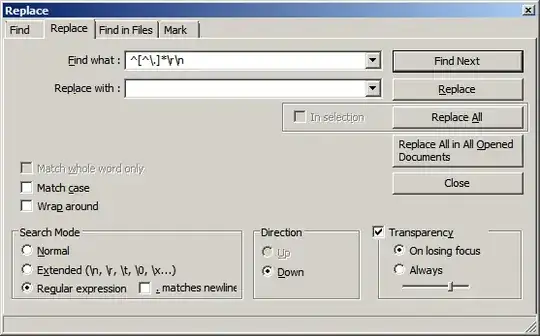

  • Menu "Search" > "Replace" (or Ctrl + H)
  • Set "Find what" to ^[^\.]*\r\n
    • You can replace \r\n with different EOL (End of Line) regular expressions depending on the EOLs in your file (see "I have a different EOL in my file, what can I do?" and "I don't care what EOLs my file uses, what can I do?" below).
  • Clear "Replace with"
  • Enable "Regular expression"
  • Click "Replace All"

  • The above assumes that the last line in the file has a trailing EOL.
  • The above also assumes you are editing a text file with Windows EOLs, \r\n.
