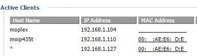

And then problems started, I couldn't get on the web even though I had an ip address or 192.168.1.110. I looked in the menu and I see two active devices with the same MAC address. Kubuntu was given two ips, the one it declared and the one DHCP gave it .127.
If I set Kubuntu to use DHCP I get .127 and get get online. It will ignore the static assignment on the router. If I request .110 in Kubuntu wierd things happen, I get two connections with two different interfaces for connection rt1. I will get (rt1 (enpl0s) this is systemd's name for the ethernet) and (rt1 (virbr0 (this is the bridge for windows). This never happened before as it has always been simply rt1.
So i look on DD-WRT and see this: (MAC gets two ips, conflicts all around)
I'm just trying to get back to my working config now and it's not happening.
Kubuntu shows no connections in network config, but if I run ifconfig I have all these broken duplicate connections that aren't in /etc/network/interfaces.
I noticed DD-WRT has two active connections for my nic, but if I look in DHCP clients only the working ip .127 will appear. From DHCP clients I can erase the .127, this will make the name a * in active connections however .110 will still remain there.
I tried rebooting the router to no avail. Why are static IP's so cumbersome? I thought it was supposed to be simpler and more abolute than DHCP.
