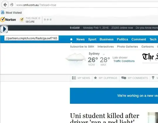

I suspect, but am not certain, that the pop-ups that slip through have something to do with this Flash element pointing to //partners.cmptch dot com that has introduced itself onto the page:
Suspect Flash Element
