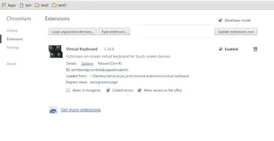

I then installed an unpacked extension extension on PC1, however this never appears on PC2. I have went to settings > extensions > checked 'Developer Mode' and clicked 'update extensions now' - nothing.

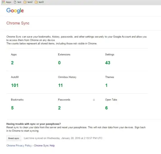

  • What does https://www.google.com/settings/chrome/sync show?

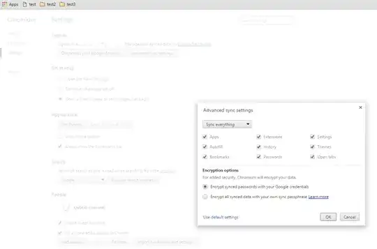

    If you don't see the extensions showing there make sure it's enabled by going to Settings -> Advanced Sync Settings
    – JasonSec Jan 20 '16 at 13:20
    it appears you've loaded this extension from your local drive which isn't tracked by google and thus not synced. Try installing from https://chrome.google.com/webstore/detail/virtual-keyboard/pflmllfnnabikmfkkaddkoolinlfninn?hl=en instead. – JasonSec Jan 20 '16 at 15:27
  • Well that's the problem...google syncs only what it knows you've installed from their webstore not what you've installed locally. – JasonSec Jan 21 '16 at 13:13
Yes, I agree with JasonSec. Sync doesn't work for unpacked extensions because they are loaded locally. And the reload option simply load the extension again from you hdd.
