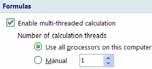

If a VBA function is called from several formulas or if your script generates or forces the recalculation of several formulas, then this should definitely make use of the multi-threaded calculation feature of Excel. Respectively, this would either run multiple instances of your VBA function for each formula, or recalculate multiple cells simultaneously while your vba script is running on a single thread.
You can limit the number of threads used by Excel to recalculate formulas in Excel Options... Advanced Tab... Formulas section.

  • @learningAsIGo Right, I simplified my answer. Let us know whether setting the number of threads to 1 helps. – mtone Jan 13 '16 at 00:30
    This seems to have done the trick. I set it to 3 cores and it maxes at 75% of CPU leaving me plenty of room to do other things. Thanks! – learningAsIGo Jan 13 '16 at 01:00
