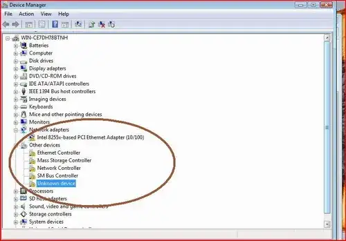

  1. Open Device Manager. The quickest way to do this on Windows 7 is to press Win + R, and type mmc devmgmt.msc
  2. Your devices will likely be listed as Unknown Device, Other device or possibly within their relevant categories but without a driver. Look for anything labelled Ethernet controller or Network controller. If not, it may simply be Unknown device. At this stage, it's hard to know. Device Manager
  3. Double click one of these. Go to the Details tab.

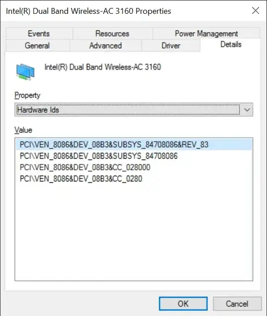

  5. For most devices, you should get a similar screen to this: Hardware IDs
  6. The important parts here, using my wireless as an example, are the VEN_8086 and DEV_08B3 parts. These are used to identify my exact device, using the Vendor ID and Device ID. In this instance, VEN_8086 is always an Intel device. We're a step closer. The next part, DEV_08B3 is the exact device by this vendor.
  7. From here, a simple search online on our internet enabled device, for VEN_8086 DEV_08B3, will almost always reveal exactly what device I have, especially for such a well known vendor as Intel. Google search result.
