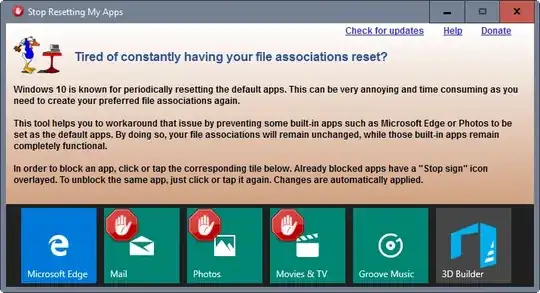

An explanation and solution is given at ghacks.
You can either use Stop Resetting My Apps which was developed to stop this resetting
or modify the registry by hand.
