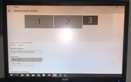

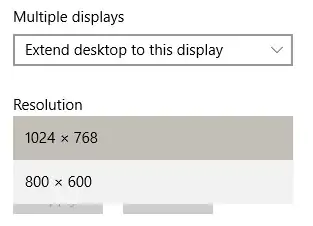

After updating my graphics driver to the latest version from NVIDIA (downloaded direct, not using Windows Update), my third monitor which is an Acer V226WL is not displaying the proper and native resolution. The native resolution is 1680 x 1050. I have a GeForce 660, and have had no problems until now with my monitors. The monitor is connected via DVI.
Incorrect resolution:

That would explain how in the first screenshot you posted it shows "didn't detect another display."
Patrick
  • 153
  • No, it said "didn't detect another display" because I clicked "detect" and since I don't have 4 monitors nothing else was there to detect. I will be playing around with combinations when I'm home, but I do want to point out I used a brand new DVI cable and the same thing is happening. And also, of course, the GTX 660 supports up to 4 displays. – Insane Dec 10 '15 at 06:05

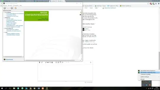

  4. Right click the icon again, and select Open NVIDIA control panel (or something similar). You'll get the good ol' NVIDIA control panel, as the image below shows. Here you should find options and ways to more precisely adjust your screen resolution.
