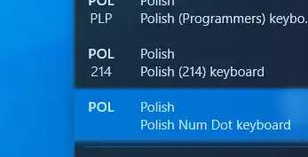

Answering here as this was the first result which came up for my problem.
I was able to fix this in Latvian keyboard by going into its options and changing Latvian (Standard) QWERTY to Latvian (QWERTY) QWERTY.
Adding Polish to see if the same could be done there shows no luck. The only available Polish (Programmers) QUERTY and Polish (214) QUERTZ neither have . as a numeric pad decimal separator.
But I was able to make a native working Polish layout with dot on numpad with MSKLC. Load existing keyboard > edit project properties > validate > build > install > restart.
Here is my build. It is installable.
