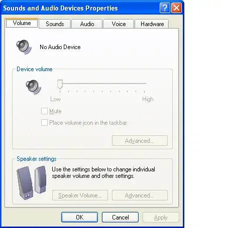

You can see there is one entry listed involving sound in the pic but in fact the sound device is not working, I opened the Sounds and Audio Devices in Control Panel and here is what it shows:
It looks like drivers are missing but I don't know what to download. Technically I need to know about the hardware info but it is not even listed for me to see any piece of info to search for the drivers. I've tried googling around and found out about RemoteFX and Integration services but they seem to be used only in a Windows Server host. I've also seen some screen shot showing info about 1 video adapter called Microsoft Hyper-v Video but I'm not sure about the guest OS as well as how to make that available in my XP guest. I've tried googling for its driver but not found anything.

What you need is the vmguest.iso from an older version of Hyper-V to install the Integration Components (IC). You can get the IC from Hyper-V 2012/2012R2 Server, a free download, here:
https://www.microsoft.com/en-us/evalcenter/evaluate-hyper-v-server-2012-r2 (you’ll need to either find a way to extract it or install Hyper-V Server in a VM to get the vmguest.iso)
Or, if you’ve got a Windows 8/8.1/2012/2012R2 VM/system available with Hyper-V installed you’ll find it in the C:\windows\system32\ folder.
You could probably also use the vmguest.iso from Hyper-V Server 2008/2008R2 as well.
see: https://smudj.wordpress.com/2017/03/02/vmguest-iso-for-older-windows-oses-in-win102016/
---additional info added 2018Apr
I have updated the blog post listed above to include a download for the 2012R2 vmguest.iso file. If you prefer a trusted source, download Hyper-V server 2012 R2 from Microsoft. ( to extract, you’ll need to mount the ISO, open the x:\sources\install.wim file with something like 7zip, browse to Windows\system32, and extract the vmguest.iso or install Hyper-V Server in a VM to get the vmguest.iso)
The Integration Components will auto-install when you mount the vmguest.iso from Hyper-V 2012R2 and install drivers for the video card. The other 2 devices are not needed.
The 2 remaining unknown devices are expected and can be ignored for OSes earlier than Windows Server 2012 R2.
Per Microsoft they are only supported on Windows Server 2012R2 OSes and higher: https://support.microsoft.com/en-us/help/2925727/unknown-device-vmbus-in-device-manager-in-virtual-machine-for-avma
