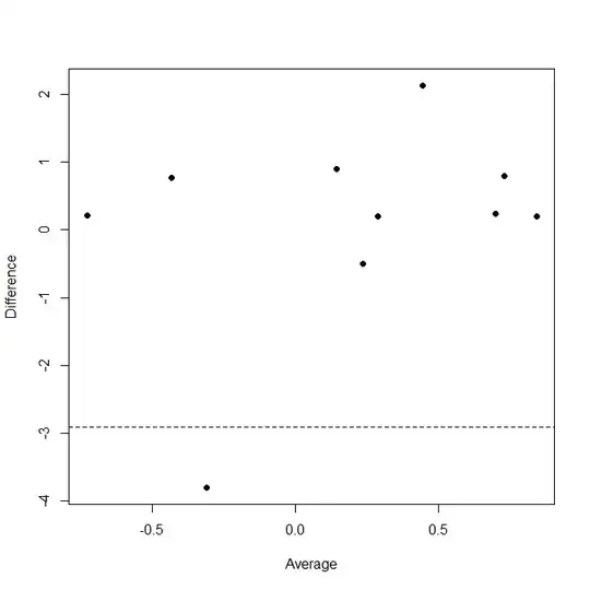

You don't plot "the mean of the data", but for each data point measured in two ways, you plot the difference in the two measurements ($y$) against the average of the two measurements ($x$). Using R and some toy data:

> plot(xx, yy, pch=19, xlab="Average", ylab="Difference")
Bland-Altman plot without limits of agreement
To get the limits of agreement (see under "Application" in the Wikipedia page), you calculate the mean and the standard deviation of the differences, i.e., the $y$ values, and plot horizontal lines at the mean $\pm 1.96$ standard deviations.

> abline(h=c(upper,lower), lty=2)
Bland-Altman plot with limits of agreement
(You can't see the upper limit of agreement because the plot only goes up to $y\approx 2.1$.)
As to the interpretation of the plot and the limits of agreement, again look to Wikipedia:
If the differences within mean ± 1.96 SD are not clinically important, the two methods may be used interchangeably.
