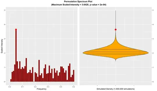

Use the spectrum.test function in the ts.extend package
Your question does not specify how you got this transformation of your signal, and I have little to say about it in the absence of further information. In any case, it is possible to test for a signal in noise (without assuming that the noise is normally distributed) using a "permutation-spectrum test". This is an extension of Fisher's test for detecting a signal in white noise. The test operates on the time-series rather than the transformation you have given, and it is quite simple to implement.
The test is implemented in the spectrum.test function in the ts.extend package in R. Here is an example where we generate data with a periodic signal and then test for the presence of the signal. The test output and resulting plot easily detects the signal.

#Conduct permutation-spectrum test TEST <- spectrum.test(SERIES) TEST Permutation-Spectrum Test
data: real time-series vector SERIES with 100 values maximum scaled intensity = 3.6428, p-value = 0.000208 alternative hypothesis: distribution of time-series vector is not exchangeable (at least one periodic signal is present)
#Plot the test results plot(TEST)
