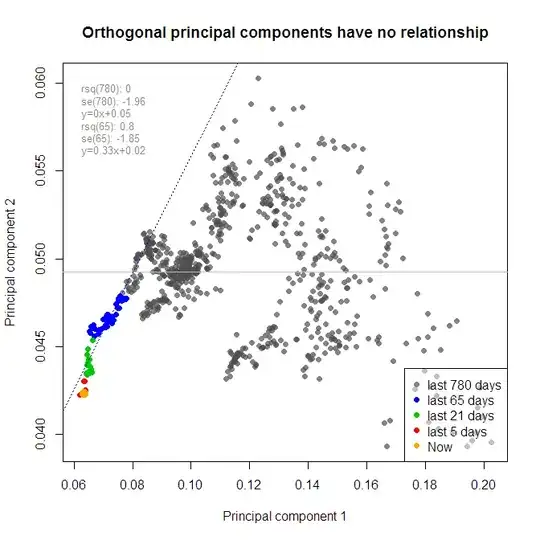

Interestingly, and as expected, if the independent variables are orthogonal as in PCA regression, then we do not need to take out the influence of each of the regressors against each other. In this case it is true that:
lm(lm(x ~ y1)$residuals ~ y2)$residuals
is perfectly correlated with:
lm(x ~ y1 + y2)$residuals
as can be seen here:
This is because the orthogonal principal components have a zero-slope regression line and thus the residuals are equal to the dependent variable (with a vertical translation to mean=0).
