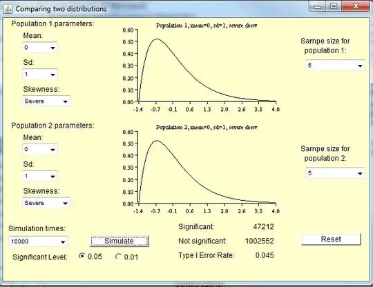

See my previous answer to a question on the robustness of the t-test.
In particular, I recommend playing around with the onlinestatsbook applet.
The image below is based on the following scenario:
  • null hypothesis is true
  • fairly severe skewness
  • same distribution in both groups
  • same variance in both groups
  • sample size per group 5 (i.e., much less than 50 as per your question)
  • I pressed the 10,000 simulations button about 100 times to get up to over one million simulations.
The simulation obtained suggests that instead of getting a 5% Type I errors, I was only getting 4.5% Type I errors.
Whether you consider this robust depends on your perspective.
