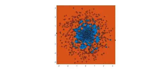

The input features may not contain enough information about class labels to perfectly predict them. In these cases, perfectly separating the training data would be overfitting, and would hurt generalization performance. Consider the following example, where points from one class are drawn from an isotropic Gaussian distribution, and points from the other are drawn from a surrounding, ring-shaped distribution. The optimal decision boundary is a circle through the low density region between these distributions. The data aren't truly separable because the distributions overlap, and points from each class end up on the wrong side of the optimal decision boundary.
As mentioned above, an RBF kernel with small bandwidth allows linear separability of the training data in feature space. A hard-margin SVM using this kernel achieves perfect accuracy on the training set (background color indicates predicted class, point color indicates actual class):
The hard margin SVM maximizes the margin, subject to the constraint that no training point is misclassified. The RBF kernel ensures that it's possible to meet this constraint. However, the resulting decision boundary is completely overfit, and will not generalize well to future data.
Instead, we can use a soft margin SVM, which allows some margin violations and misclassifications in exchange for a bigger margin (the tradeoff is controlled by a hyperparameter). The hope is that a bigger margin will increase generalization performance. Here's the output for a soft margin SVM with the same RBF kernel:
Despite more errors on the training set, the decision boundary is closer to the true boundary, and the soft margin SVM will generalize better. Further improvements could be made by tweaking the kernel.
