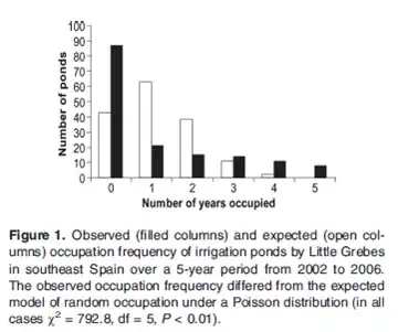

The figure below (Figure 1 from p. 646 of this paper) compares observed values against expected values under the Poisson distribution. It then runs a chi-squared test to see if the observed values differ from the expected values under Poisson distribution.
Using R, how is it possible to generate expected values under Poisson distribution and compare observed values using a chi-squared test?

Here's my attempt at doing what they did in paper. I want to know if the observed distribution of variable differs from a Poisson distribution. I also want to know if what I have done below is the same procedure as what they did in paper. As the P-value is >0.05, I have concluded below that the distribution of variable follows a Poisson distribution - could someone confirm this?
