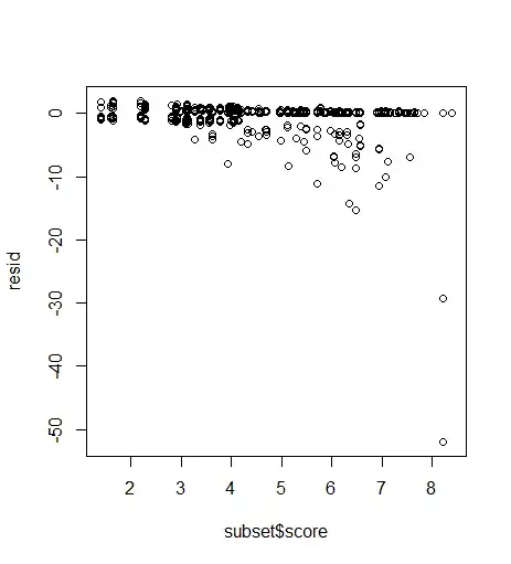

I plot the residuals against the continuous predictor
 plot(subset$score,resid)
This plot of residuals against the continuous predictor is worrying and shows a clear pattern of more negative and dispersed residuals when score increases (the task becomes easier).

Are these patterns strong enough to abandon the model? I would think that they are not, since the plots look very much like the ones from the links, except there is a general tendency to predict more "y=1" i gather.
I know there is a ceiling effect in my data, with some easy conditions having almost only correct responses (y=1). This is why I am being maybe overly skeptical about my model. Are these patterns a symptom of this?

  • apparently this might simply be the type of pattern predicted by the logit function as in this thread: link usually the two lines in resid vs fitted are centrally symmetric. Here this is not the case because there are not enough "y=0" responses predicted. This is my guess at this point. Any insight welcome. – user42174 Mar 19 '14 at 12:49
This looks fairly reasonable to me; I don't think the inference based on this model is likely to be far off. However, to take a more positive attitude, any deviation in your residuals also implies a chance to improve the model (i.e., there is further information that could be modeled).
  • Does the full model show the same deviations? That is, even though the variables you've discarded were non-significant, they might help address the (slight) pattern in the residuals.
  • You might be able to improve the model fit by modifying the link function (or equivalently transforming the predictor variables/linear predictor). In How to assess the fit of a binomial GLMM fitted with lme4 (> 1.0)? , where a similar pattern of residuals is discussed, I show how to construct a power-logit family of link functions that can be used for testing goodness-of-link and/or improving the model. (Existing goodness-of-link tests such as Pregibon's test use linearization and score tests to evaluate goodness of fit in an efficient way by comparing the existing fit to a family of link functions; the procedure at the linked question does the same thing in a much more brute-force way.) You might also find similar families of alternate link functions provided in the glmx package.

  • ok, thanks a lot for your feedback. I'll try adding some dropped variables again. I don't want to change the link for now as i would be venturing in water far above my waist.
    i must say i am surprised that the model has no problem at all dealing with the ceiling performance (for example, a repeated measure ANOVA on the number of "correct" responses completely failed on this data, showing absolutely all effects and interaction highly significant with ridiculous p values)
