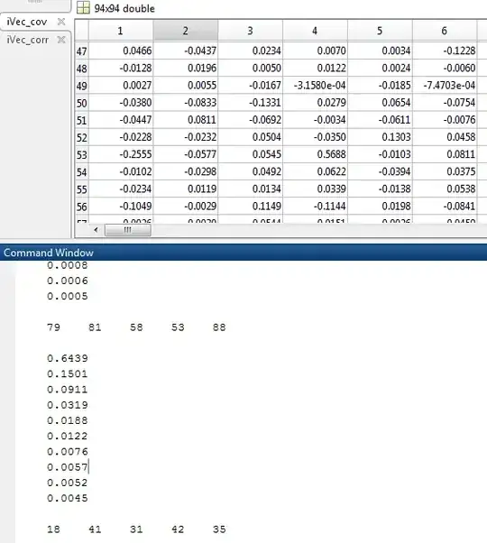

If I have 50 variables in my PCA, I get a matrix of eigenvectors and eigenvalues out (I am using the MATLAB function eig).
I have normalised the eigenvalues to sum to 1, and they are returned already sorted by magnitude. I just want to know how to match them to the variables, by looking at the matrix of eigenvectors. I know the largest eigenvector coefficient corresponds to the largest eigenvalue, but is that the largest absolute value, or is it always the largest positive value, so closest to positive infinity?
From the image below, you can see in the command window the normalised eigenvalues (64.39%, 15.01% ...) and in the window at the top there is a part of the corresponding eigenvector matrix. You can see there are positive and negative values. I hope that helps make my question clear.
snippet from Matlab
