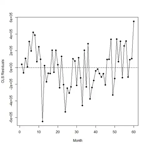

Here are the OLS residuals: Residuals

    It looks like some of the t statistics are favorable (ma1, sar1, v1). Also, could you add to the post some information on how autocorrelated the residuals are, such as the Durbin-Watson statistic? They don't look that autocorrelated. If you do believe there is still autocorrelation, add another autocorrelation term to the arima and check how the AIC changes. – John Mar 04 '14 at 16:23
  • do you have acf/pacf of residuals? why do you think they're autocorrelated? – Aksakal Mar 04 '14 at 16:45
  • Added ACF/PACF for the residuals of the OLS model, as well as DW statistics. It should be noted that v6 in the OLS model is a dummy seasonal variable (0/1 marking the month of interest), which I excluded from the xreg in auto.arima in favor of letting it decide the seasonality structure. I'm sensing that the opinion so far is that sARIMA is not necessary, which confuses me because looking at the original data it sure looks like an obvious candidate for ARIMA errors. Perhaps I'm making this harder than it needs to be? – Geoffrey Mar 04 '14 at 17:18
  • @Geoffrey, your residuals do not show any obvious autocorrelation, which is not surprising since you used auto.ARIMA. so the model looks fine in this regard. your variables dont seem to explain anything in the model. – Aksakal Mar 04 '14 at 17:30
  • @Aksakal, those are the autocorrelations for the OLS model, not auto.arima. Have I misunderstood your request in that regard? – Geoffrey Mar 04 '14 at 17:32
    @Geoffrey, whatever the autocorrelations, they're benign. I thought you ran the ARIMA model. maybe I'm confused. If you ran OLS, and got these nice residuals, then i'd stick to OLS, as long as your coefficients look good. – Aksakal Mar 04 '14 at 17:46
  • @Aksakal, my apologies for the confusion. I ran an OLS model, THEN an ARIMA model to incorporate the autocorrelation structure of the errors. The first three plots refer to the OLS model. I guess I'm surprised that this data isn't autocorrelated... – Geoffrey Mar 04 '14 at 17:53
    @Geoffrey, you see the peak at 12 in your ACF? that's the seasonality, the only obvious issue. I would try first OLS with the seasonal dummy. start with monthly dummies, then try to reduce the number of dummies, you may end up with just one month dummy. e.g. in financial series, you often see jumps around the tax season in April, so a single dummy takes care of it in many cases – Aksakal Mar 04 '14 at 18:43
  • @Aksakal: So the residuals aren't autocorrelated, but the spike at 12 shows that (yearly) seasonality isn't being handled well? Geoffrey: Your graphs refer to the residuals, which gives you an idea if your model is missing some factor over time. The data itself is probably autocorrelated, but your variables account for that. At least that's my understanding of things. – Wayne Mar 04 '14 at 18:44
  • @Wayne, as I wrote, peak 12 is not necessarily SAR(12), it could just be one month in the year, such as December – Aksakal Mar 04 '14 at 18:45
  • @Aksakal: Thanks. I started my comment before your comment about the single month showed up. – Wayne Mar 04 '14 at 18:47
