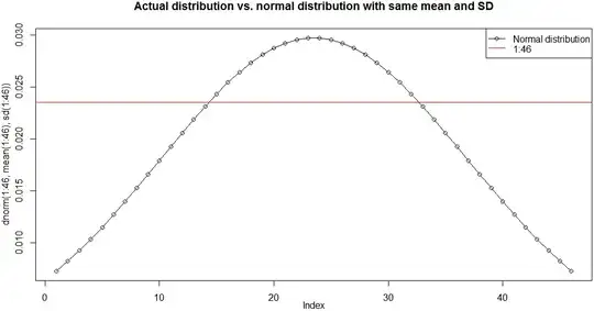

As the other Nick (@NickCox) noted, $.077>.05$. Still, I suppose this puts you close enough for concern to the conventional $\alpha=.05$ – that is, I support your intuition to not ignore the result just because it doesn't quite fall below the presumptive threshold, which is quite often a poor way to perform hypothesis testing anyway. As @Glen_b commented on @Germaniawerks' answer, you could fail to achieve significance due to wimpy (as opposed to ful) sample sizing despite nonnormality. Observe (in R)! shapiro.test(1:46): $W=.96, p=.079$, much like your result.
Compare to superior ways of judging normality:
As the red line shows, 1:46 $(1,2,3...46)$ is very much not normally distributed – it's totally flat – but it still takes 46 observations to achieve even your "insignificant" result with a Shapiro–Wilk test! Well-behaved for small datasets indeed...BTW, see how much more this actually tells you about your data than just "approximately normal" or not? Don't underestimate the value of simply plotting data! Your eyes can often tell you a lot more than some test statistic.
