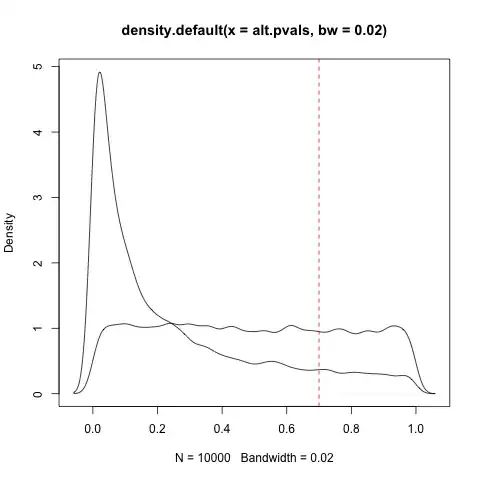

Now let's consider the alternative hypothesis- cases where the null is false. Now, this is a bit more complicated: when the null is false, "how false" is it? The mean of the sample isn't 0, but is it .5? 1? 10? Does it randomly vary, sometimes small and sometimes large? For simplicity's sake, let's say it is always equal to .5 (but remember that complication, it'll be important later):
alt.pvals = replicate(10000, t.test(rnorm(10, mean=.5, sd=1))$p.value)
hist(alt.pvals)
Notice that the distribution is now not uniform: it is shifted towards 0! In your comment you mention an "asymmetry" that gives information: this is that asymmetry.
So imagine you knew both of those distributions, but you're working with a new experiment, and you also have a prior that there's a 50% chance it's null and 50% that it's alternative. You get a p-value of .7. How can you get from that and the p-value to a probability?
What you should do is compare densities:
lines(density(alt.pvals, bw=.02))
plot(density(null.pvals, bw=.02))
And look at your p-value:
abline(v=.7, col="red", lty=2)
That ratio between the null density and the alternative density can be used to calculate the local false discovery rate: the higher the null is relative to the alternative, the higher the local FDR. That's the probability that the hypothesis is null (technically it has a stricter frequentist interpretation, but we'll keep it simple here). If that value is very high, then you can make the interpretation "the null hypothesis is almost certainly true." Indeed, you can make a .05 and .95 threshold of the local FDR: this would have the properties you're looking for. (And since local FDR increases monotonically with p-value, at least if you're doing it right, these will translate to some thresholds A and B where you can say "between A and B we are unsure").
Now, I can already hear you asking "then why don't we use that instead of p-values?" Two reasons:
  1. You need to decide on a prior probability that the test is null
  2. You need to know the density under the alternative. This is very difficult to guess at, because you need to determine how large your effect sizes and variances can be, and how often they are so!
You do not need either of those for a p-value test, and a p-value test still lets you avoid false positives (which is its primary purpose). Now, it is possible to estimate both of those values in multiple hypothesis tests, when you have thousands of p-values (such as one test for each of thousands of genes: see this paper or this paperfor instance), but not when you're doing a single test.
Finally, you might say "Isn't the paper still wrong to say a replication that leads to a p-value above .05 is necessarily a false positive?" Well, while it's true that getting one p-value of .04 and another p-value of .06 doesn't really mean the original result was wrong, in practice it's a reasonable metric to pick. But in any case, you might be glad to know others have their doubts about it! The paper you refer to is somewhat controversial in statistics: this paper uses a different method and comes to a very different conclusion about the p-values from medical research, and then that study was criticized by some prominent Bayesians (and round and round it goes...). So while your question is based on some faulty presumptions about p-values, I think it does examine an interesting assumption on the part of the paper you cite.
