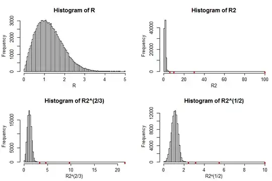

In the absence of a specification of what makes an outlier, here's an example:
This is the same data as above (a large sample from a Rayleigh distribution with $\sigma=1$). In the second panel I have added four outliers (at 6, 10, 30 and 100), marked in red. In the third panel, we see the effect of the power $p=\frac{2}{3}$ and in the last panel the effect of the power $p=\frac{1}{2}$. Note that for the Rayleigh data, $\mu+3\sigma$ is at about 3.22. The value at 6 is already far enough away as to be considered highly unlikely even in a quite large sample with that level of skewness -- an outlier in some sense. You can see that the transformation brings it back toward the main part of the data, so that by the last panel it's visually a somewhat mild outlier, fairly borderline given the sample size (about 4.5 sd's above the mean).
The value 10 (on the original scale), while clearly an outlier, is noticeably less discrepant but still clearly inconsistent with the idea that the data are normal, and the larger values even more so.
So they do in some sense "come in" -- but as to whether the status of them being 'outliers' has changed depends very much on how you define 'outlier'.

  • Glen_b, The 0.6 one looks to be the best on my eye. This is really cool and interesting! To answer your question about the outliers: I have nominally Rayleigh distributed data, but ~ < 1% are corrupt and have inordinately large values. I was wondering if putting this data through a transformation to make it gaussian, would also preserve the "outlierness" of the corrupted data. Does that make sense? – Creatron Feb 11 '14 at 00:13
