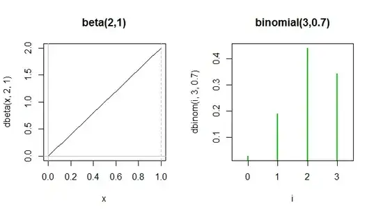

Or consider a $\text{beta}(2,1)$; it's hard to find a binomial which looks similar. Here's one attempt:
The entire beta pdf sits between the first two green spikes in the binomial pf, though they can't really be shown on the same plot because the y-axes measure different things.
While the shapes are vaguely similar in the sense that they're both left skew, they're really quite different, and used for different things.
