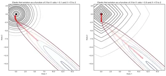

Visualizing the impact of the parameters
Consider a simulated data set where $y$ consists of a noisy sine curve and $X$ is a two dimensional feature consisting of $X_1 = x$ and $X_2 = x^2$. Due to correlation between $X_1$ and $X_2$ the cost function is a narrow valley.
The graphics below illustrate the solution path of elasticnet regression with two different $L_1$ ratio parameters, as a function of $\lambda$ the strength parameter.
  • For both simulations: when $\lambda = 0$ then the solution is the OLS solution on the bottom right, with the associated valley shaped cost function.
  • As $\lambda$ increases, the regularization kicks in and the solution tends to $(0,0)$
  • The main difference between the two simulations is the $L_1$ ratio parameter.
  • LHS: for small $L_1$ ratio, the regularized cost function looks a lot like Ridge regression with round contours.
  • RHS: for large $L_1$ ratio, the cost function looks a lot like Lasso regression with the typical diamond shape contours.
  • For intermediate $L_1$ ratio (not shown) the cost function is a mix of the two

You can see this visually on the diagram above, the singularities at the vertices encourage sparsity, while the strict convex edges encourage grouping.
