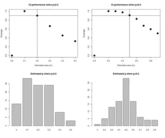

Step 3: Test the prediction interval coverage Theoretically we expect the prediction intervals developed above to be very good if $p$ is estimated correctly, but perhaps very bad if it is not. To test the coverage, the following function assumes the true value of $p$ is known, and then repeatedly makes an estimate of $p$ based on 10 coin flips (using the fraction of observed heads), and computes a prediction interval with the estimated value of $p$.

A few tests confirm that the coverage is nearly correct when $p$ is estimated correctly, but can be very bad when it is not. The figures show tests with real $p$ =0.2 and 0.5 (vertical lines), and a theoretical coverage of 0.9 (horizontal lines). It is clear that if the estimated $p$ is too high, then the prediction intervals tend to undercover, whereas if the estimated $p$ is too low, they over-cover, except if the estimated $p$ is zero, in which case we cannot compute any prediction interval (since with the plug-in estimate, heads should never occur). With only 10 samples to estimate $p$, often the coverage is far from the theoretical level.
t5=test_ci_with_estimated_p(0.5,theoretical_coverage=0.9)
t2=test_ci_with_estimated_p(0.2,theoretical_coverage=0.9)
png('test_CI.png',width=12,height=10,res=300,units='in')

Test of CI performance
In the above examples, the mean coverage was pretty close to the desired coverage when true $p$=0.5 (87% compared with the desired 90%), but not so good when true $p$=0.2 (71% vs 90%).
