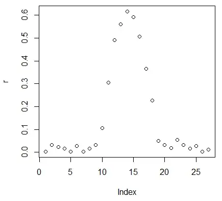

I am quite new to statistics, so please forgive me for using probably the wrong vocabulary.
I have some data that looks (to me) like a gaussian when plotted.
The data is an extract from a jpeg image. It's a vertical line taken from the image, and only the Red data is used (from RGB).
Here is the full data (27 data points):
> r
 [1] 0.003921569 0.031372549 0.023529412 0.015686275 0.003921569 0.027450980
 [7] 0.003921569 0.015686275 0.031372549 0.105882353 0.305882353 0.490196078
[13] 0.560784314 0.615686275 0.592156863 0.505882353 0.364705882 0.227450980
[19] 0.050980392 0.031372549 0.019607843 0.054901961 0.031372549 0.015686275
[25] 0.027450980 0.003921569 0.011764706
> dput(r)
c(0.00392156862745098, 0.0313725490196078, 0.0235294117647059,
0.0156862745098039, 0.00392156862745098, 0.0274509803921569,
0.00392156862745098, 0.0156862745098039, 0.0313725490196078,
0.105882352941176, 0.305882352941176, 0.490196078431373, 0.56078431372549,
0.615686274509804, 0.592156862745098, 0.505882352941176, 0.364705882352941,
0.227450980392157, 0.0509803921568627, 0.0313725490196078, 0.0196078431372549,
0.0549019607843137, 0.0313725490196078, 0.0156862745098039, 0.0274509803921569,
0.00392156862745098, 0.0117647058823529)
plot(r)
I would like to find a gaussian that is as close as possible to the plot/data.
I tried with normalmixEM from the R package mixtools.
> fit = normalmixEM(r)
but this seems to try to fit to a mix of two gaussian by default.
I tried to specify that there is only one gaussian using the parameter k:
> fit = normalmixEM(r, k = 1)
Error in normalmix.init(x = x, lambda = lambda, mu = mu, s = sigma, k = k,  :
  arbmean and arbvar cannot both be FALSE
How can I fit the data?

  • You don't plot a sequence of data values to see the distribution. Does $r$ already represent a frequency or probability density of data values? – Scortchi - Reinstate Monica Jan 22 '14 at 15:58
  • I have answered this question several times in several contexts. An R solution for a discrete variable like your Index appears at http://stats.stackexchange.com/a/43004/919; an R solution for a continuous variable is at http://stats.stackexchange.com/questions/70153/linear-regression-best-polynomial-or-better-approach-to-use/70184#70184; and an Excel solution is at http://stats.stackexchange.com/a/11563/919. – whuber Jan 22 '14 at 16:45
There's a difference between fitting a gaussian distribution and fitting a gaussian density curve. What normalmixEM is doing is the former. What you want is (I guess) the latter.
Fitting a distribution is, roughly speaking, what you'd do if you made a histogram of your data, and tried to see what sort of shape it had. What you're doing, instead, is simply plotting a curve. That curve happens to have a hump in the middle, like what you get by plotting a gaussian density function.
To get what you want, you can use something like optim to fit the curve to your data. The following code will use nonlinear least-squares to find the three parameters giving the best-fitting gaussian curve: m is the gaussian mean, s is the standard deviation, and k is an arbitrary scaling parameter (since the gaussian density is constrained to integrate to 1, whereas your data isn't).

I propose to use non-linear least squares for this analysis.
# First present the data in a data-frame
tab <- data.frame(x=seq_along(r), r=r)
#Apply function nls
(res <- nls( r ~ k*exp(-1/2*(x-mu)^2/sigma^2), start=c(mu=15,sigma=5,k=1) , data = tab))
And from the output, I was able to obtain the following fitted "Gaussian curve":
v <- summary(res)$parameters[,"Estimate"]
plot(r~x, data=tab)
plot(function(x) v[3]*exp(-1/2*(x-v[1])^2/v[2]^2),col=2,add=T,xlim=range(tab$x) )
The fit is not amazing... Wouldn't a $x \mapsto \sin(x) / x$ function be a better model?
  • Thanks. I get residual sum-of-squares: 0.01997. I think I am getting exactly the same with the solution from Hong Ooi above. Is the algo the same? Also how do I plot the result of nls? – Timothée HENRY Jan 22 '14 at 20:30
  • Yeah, the algorithms are the same in the sense that if they work (don't get stuck in some local minimum) they give the same answer. Depending on the value given to method= they can be exactly the same. – Rasmus Bååth Jan 23 '14 at 09:06
    I added two lines to generate the plot. – Vincent Guillemot Jan 23 '14 at 09:17
