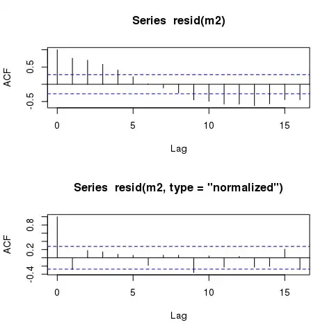

By means of comparison, here are the ACFs of the raw (response) and the normalised residuals
layout(matrix(1:2))
acf(resid(m2))
acf(resid(m2, type = "normalized"))
layout(1)
To see why this is happening, and where the raw residuals don't include the correlation term, consider the model you fitted
$$y = \beta_0 + \beta_1 \mathrm{time} + \beta_2 \mathrm{x} + \varepsilon$$
where
$$ \varepsilon \sim N(0, \sigma^2 \Lambda) $$
and $\Lambda$ is a correlation matrix defined by an AR(1) with parameter $\hat{\rho}$ where the non-diagonal elements of the matrix are filled with values $\rho^{|d|}$, where $d$ is the positive integer separation in time units of pairs of residuals.
The raw residuals, the default returned by resid(m2) are from the linear predictor part only, hence from this bit
$$ \beta_0 + \beta_1 \mathrm{time} + \beta_2 \mathrm{x} $$
and hence they contain none of the information on the correlation term(s) included in $\Lambda$.
